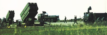

Spada 2000 Ground based air defence missile system. (Photo: MBDA)

The firing section consists of the tracking and illumination radar, the control unit and the missile launchers each with six ready-to-fire missiles. The radar carries out target acquisition, tracking and illumination functions for missile guidance.
The control unit is managed by a single operator. The unit controls all the functions from target designation to missile launch and target intercept and operates in manual or automatic mode.

Tested 8 times Italian Air Force, beginning in 2005, the configuration of the batteries SPADA 2000 Plus includes:
  • a Detection Centre focuses on RAC-3D radar, three-dimensional (radius of the discovery of 60 km, capable of simultaneously tracking up to 100 targets simultaneously and ingaggiarne 4), which brings together in one shelter also the tactical operations center responsible for the management of targets and their classification according to the level of threat and possibly also able to coordinate the fire, within a radius of 10 km, up to 10 units of anti-aircraft artillery radar Lead (systems such as Oerlikon GDF-005 35mm Bofors 40mm already supplied to the Armed Forces Pakistan or any modern unit C-Ram type the Porcupine, to remain in system concepts Italian).
  • 2 sections of fire (possibly expandable to four) made from radar tracking and illumination of the target, from the fire control and two pitchers with six Aspide 2000 missiles ready to fire.
  • The missile Asp 2000, Asp improved version of the previous (in turn national project developed from the air-to-air missile American AIM-7 Sparrow), characterized by a single-stage rocket motor, powered by solid fuel, which ensures supersonic speeds , high maneuverability and the capability to engage targets at distances greater than 25 km thanks to the semi-active homing guidance that activates the head preframmentata containing 35 kg of high explosives.
New batteries SPADA 2000 Plus, compatibly with the delivery schedule, go to replace the earlier and less accurate systems for point defense Crotale (introduced in 1976 and updated locally to the standard in the Years 4000, 2000) and are integrated into the modern network of defense national airline that is part of the Air Defense Command of the Pakistan Air Force. In this command, located in an underground bunker at the Chaklala Air Base near Rawalpindi, is managed in real time by a score of dedicated workstations, the situation of the national airspace under the four sub-sectors of operation in which the country is divided Peshawar ( North), Quetta (West), Sarghoda (Center), Karachi (South).
SPADA 2000 Plus systems are already deployed in the military part of the International Airport of Islamabad (Chaklala Air Base) and will soon be deployed to protect all other major national air bases (Jacobabad, Kahuta, Kamra, Karachi, Sargodha) as well as Site Nuclear Kushab. In any case, the full compatibility of the shelter with the C-130 Hercules of the PAF, enables the rapid deployment of the batteries in any part of the country.
With this acquisition (and the exercise of the options for an additional 5 batteries), the Pakistan Air Force fully meets the operational requirements for a medium-range SAM systems arising from the particular topography of the country. There still remains a clear need to find soon a modern long-range SAM system that replaces the few old-fashioned HQ-2 (Chinese copy of the Russian SA-2 Guideline characterized by a range of about 35km) who still defend Islamabad and enabling set up a modern multi-layered air defense at least around the capital, the city of Karachi and the nuclear site Kushab.
The system in question, you want the Pakistani military should have a capacity around 100 km, and then in the class of systems S-300 Russian, Chinese HQ-9 or SAMP / T Franco-Italian (currently being delivered to ' Italian Army) and the ability to intercept ballistic missiles at short and medium range as those found in the arsenal of historic rival India (mainly series of Prithvi SRBM and IRBM Agni series). The major stumbling block to the acquisition of such systems is still represented by their high cost, but a decision, perhaps related to the purchase of only 3 batteries for the protection of the above objectives, it is likely to be taken from here a few years in front of the impressive modernization program that is affecting the Indian Air Force and the need to balance the possible deployment by the Indian systems ATBM.
Overall, the acquisition system SPADA 2000 Plus consolidates the existing good relations between Pakistan and our defense industry (already a supplier of Grifo-7PG radar for F-7 and Falco UAV assembled locally) and, thanks to the two maintenance units created on the spot, sets the stage for further profitable future developments.

The Spada 2000 Plus system is a ground based air defence missile system designed to protect vital assets from different types of threat such as fighter and bomber aircraft,cruise missiles, helicopters and UAVs.
The Spada 2000 Plus is characterized by a high degree of modularity and flexibility, based on ISO standard modules.
Each system section comprises a Detection Center and up to four Firing Sections, each one comprising a Fire Control Center and two Missile Launchers each equipped with six missiles. The Spada 2000 Plus system is also capable of integrating V-SHORAD weapon systems and can operate autonomously or can be integrated within a higher level defence network or architecture.
Spada 2000 plus complex inauguration in Karachi
