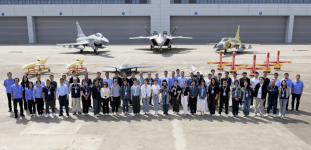

Yesterday (May 7), several national Chinese media outlets were invited to visit the headquarters of CAC and the 611 Institute.
The following is the official news report:
It is worth noting:
The JF-17 fighter in the photo is in green livery.
This indicates that the 611 Institute is still carrying out the upgrade work on the JF-17.
Will it be re-engined with the 11-ton-thrust WS-19?
WS-21, @Michael has already confirmed, IIRC.
From a technical perspective, the WS-19 engine cannot be used for the JF-17 series fighter jets.
From a political perspective, the WS-19 engine is not exported. At least for now, its export is not allowed.
Regarding the combination of the WS-19 engine and the JF-17 series fighter jets, the technical issues are very serious, far greater than the political issues.
There are two Chinese terms that I don't know how to translate. You can figure it out yourselves.
飞发一体化 and 集成热管理.
Just these two items are enough to completely prevent the WS-19 engine from being integrated with the JF-17 series fighter aircraft. Unless CAC is really willing to develop a stealth version of the JF-17.
