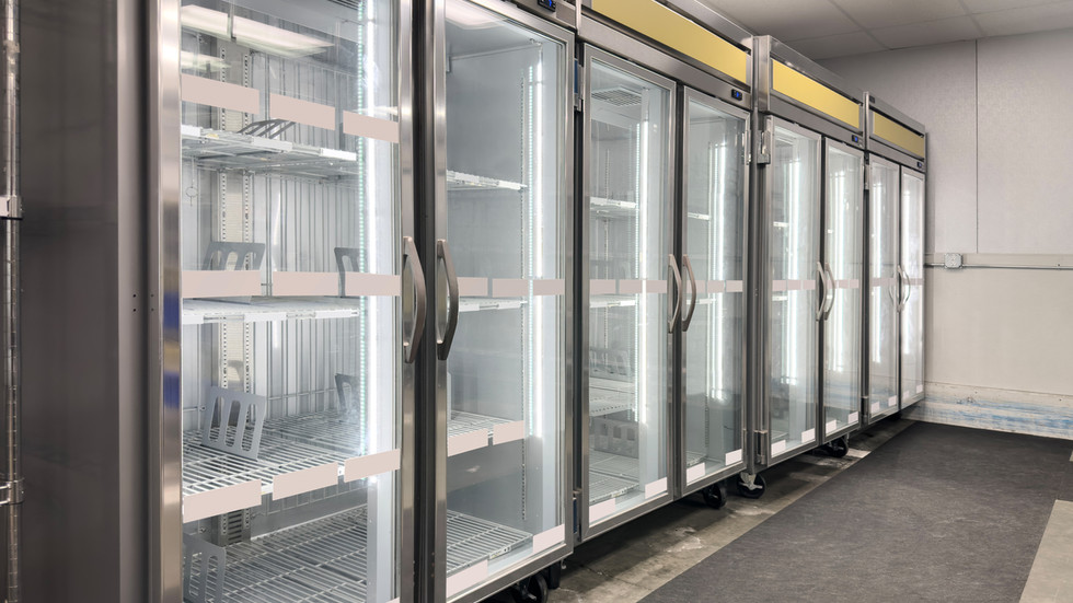

Several hundred supermarkets were victims of a large-scale cyberattack overnight from Sunday to Monday, as revealed by BFMTV . The hackers targeted the refrigeration control systems of the Danish manufacturer Danfoss, used by numerous French stores. Specifically, the attackers appear to have managed to remotely trigger the forced defrosting of the refrigeration units, a process normally used to remove accumulated frost from the equipment.
But last night, the hackers hijacked this function by forcing a continuous defrost cycle, with a temperature set to 50 degrees Celsius. As a result, the equipment heated up for several hours instead of keeping the goods cold. Early this morning, when the refrigerators and freezers were opened, "a wave of heat escaped," recounts an industry source.
