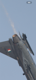

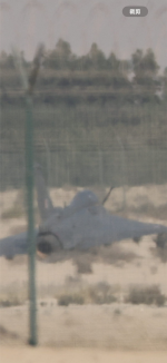

OK, here is another angle - the height appears to be insufficient for this manuever.
It should have rolled smoothly, but instead it pitched while upside down, causing the loss of height. The pilot could not have been trying a split S at the altitude.....🤔🤔
Looks like pilot tried to pull off a maneuvre that required a lot of height, but he was not at such a good height. Reminds me of F16 crash in Sept 6th rehearsals in Pakistan a few years ago.

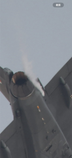

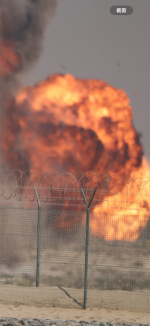

For those seeing flashes and hearing explosions. In a single engine fighter you punch out at low altitude at the first sign of engine trouble. An engine explosion is always followed by smoke and debris. Unless it's a compressor stall, a single loud bang with flames from the inlet/exhaust is a 'transient stall' typically happens when there is abnormal airflow into the engine. The pilot needs to stabilize airflow to recover from a 'transient stall' if the pop we heard is a compressor stall there was no time for recovery for this Tejas since it was so low to the ground.

The engine is the most proven and reliable and best thing in the entire jet.
If that smoke is a tell tail sign of anything, maybe there is an integration issue with the engine may be the issue(ie HAL/DRDO design flaw/issue maybe), but that engine is absolutely a solid engine.
