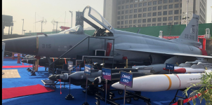

Thunders guarding the city landing gear deployed is a welcome sight though.
