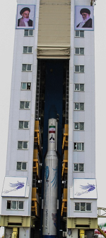

do we have launch facility capable of accommodating SLV of that size ? 4 khoramshar engine clustered would be big
the Semnan launch facility seems big enough to me, Simorgh is not exactly small itself with 2.4m diameter
even first and second stage of 1 or 2 Khorramshahr engine each would be a big improvement to Simorgh
