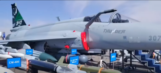

A JF-17C on the tarmac with its missile load displayed.
A JF-17C on the tarmac with its missile load displayed. - Press Service of the President of the Republic of Azerbaijan/Wikimedia Commons
Multirole joint fighters are desired by the world's militaries because they can complete numerous missions across a variety of operational environments, and the JF-17 Thunder is no exception. The aircraft is somewhat similar to China's J-10, though its several differences make the JF-17 more desirable. The Thunder costs between $25 and $30 million each, and they're armed to the teeth with with a GSh-23 dual-barrel 23mm cannon and seven hardpoints (four beneath each wing and one beneath the fuselage).
These accommodate a payload capacity of more than 8,150 lbs., enabling the JF-17 to carry PL-12 radar homing medium-range air-to-air missiles (AAM), a variety of different types of bombs, anti-radiation missiles, anti-ship missiles, and/or rocket launchers with a laser designator pod. Additionally, they can carry short-range AAMs of various types. They also possess a variety of countermeasures, sensors, and other equipment.
