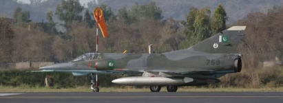

You can really tell in both these pics how Dassault made up for these early delta winged Mirages not having leading edge flaps/slats by giving the 5 a gradual built-in bend on that edge.

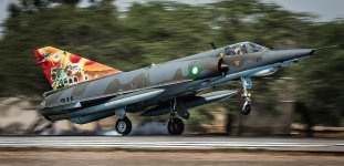

Dassault Mirage III Rose ~ The Bandits
PAF Islamabad
