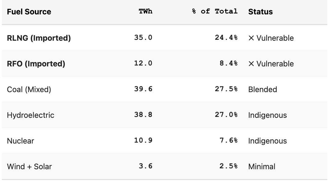

The Crisis: One-Third of Supply at Risk​
In FY 2020-21, Pakistan’s power system rested on a precarious foundation. Consider the arithmetic:
Total imported fuels: 49.5 TWh (one-third of supply). This was not a stable energy base. A thirty-day blockade of the Strait of Hormuz—through which 90% of global seaborne oil and our LNG cargoes flow, would have cost the system 2.87 TWh, enough to trigger cascading load-shedding of greater than eight hours daily and demand destruction.
“The system was not designed for this risk; it merely accepted it as the cost of energy growth.”

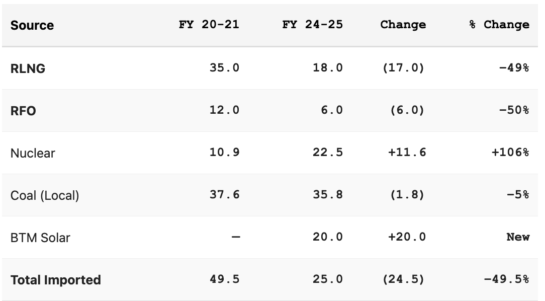

The Shift: Five-Year Transformation​
By FY 2024-25, the arithmetic has fundamentally changed:

Pillar 1: Nuclear Baseload (Policy-Driven)​
K-2 reactor, commissioned May 2021, added 1,145 MW of capacity. Nuclear generation more than doubled: from 10.9 TWh (FY 2020-21) to 22.5 TWh (FY 2023-24, +106%). This was not marginal. A 1,100 MW baseload plant running at 95% capacity factor produces 9 TWh annually—enough to displace 9 TWh of expensive RLNG.
The mechanism is straightforward: RLNG plants can be throttled back without grid instability when nuclear baseload provides the foundation. K-2 was designed precisely for this. The policy worked.

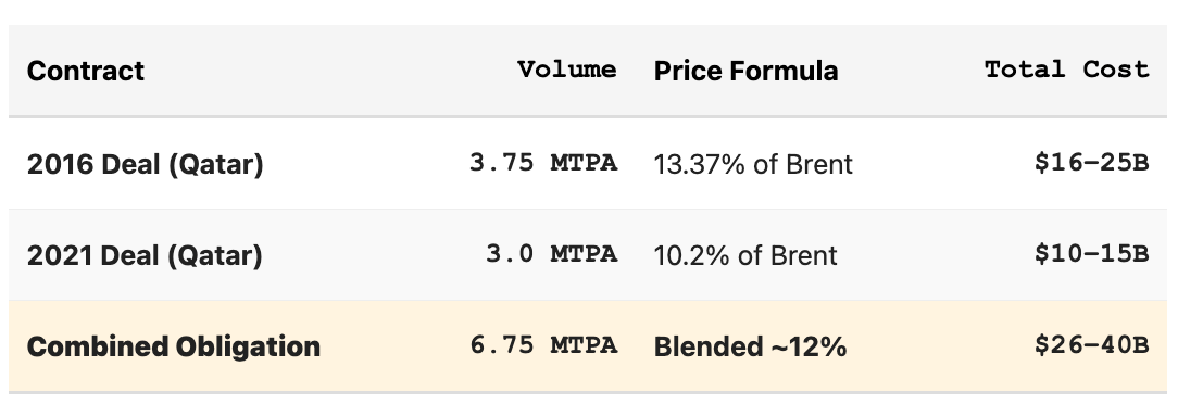

Behind the geopolitical story lies a deeper economic one. Pakistan signed two long-term contracts with Qatar backed by take-or-pay sovereign guarantees:
Under take-or-pay clauses, Pakistan was obligated to pay for contracted volumes regardless of actual demand. This created a financial trap: even if demand fell (due to economic recession, solar adoption, or cheaper coal), Pakistan was obligated to pay.
The Cost of Forced Running
Annual excess cost (FY 2022-23):
Rs 9,408 billion (~$32M USD) in forced RLNG premium vs. optimal coal/gas dispatch.
5-year cumulative economic waste: Rs 37–47 trillion ($125–160B USD). This was a hidden tax on consumers passed through tariffs.

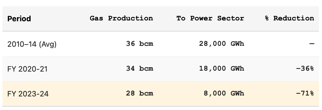

Pakistan was also actively suppressing its own domestic gas:
Petroleum Minister Ali Pervaiz Malik stated it explicitly: “Domestic gas producers are unable to sell gas to the power sector because regasified LNG plants are forced to run to absorb contractual supplies.” This is perverse: Pakistan was starving its own domestic gas sector while being forced to buy expensive imported LNG.
By reducing RLNG from 35 to 18 TWh, Pakistan freed up pipeline capacity for domestic gas and allowed coal to reclaim merit order. The economic stranglehold was released.

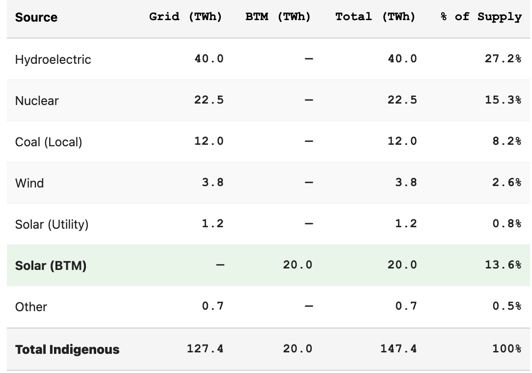

The Total Picture: 147 TWh Indigenous​
When you add grid generation (127.4 TWh) to BTM solar (20 TWh), Pakistan now generates 147.4 TWh of total indigenous power. Only 25 TWh is imported.
Energy independence: 85% (up from 66%). All actual electricity consumption is met by domestic sources: hydropower, nuclear, local coal, wind, solar (utility + BTM), and renewables. Imported fuel dependency has been nearly eliminated except for marginal RLNG/RFO for peak shaving.
