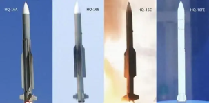

Or a SM-2 size missile with significantly less range then a ESSM, it's impressive how inefficient the HQ-16 is, it always amazes me why the Chinese chose this over the Sky dragon 50 which had a greater range while being half the size.
HQ-16 missile is 690kg, 1.3ton likely includes the canister.
That's basically the Same weight as a SM-2 block 3C which weighs 708KGs, HQ-16 has a range of 40KMs, the SM-2 block3C has a range of 170KM+
sm2 has a huge warhead too, 3x the size of the hq16s
now to be fair to the 16, its an old missile, the HQ16FE is a far better representation of what can be done in a similar footprint

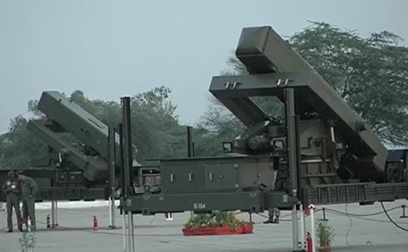

This actually makes me curious, can the normal HQ-16 launchers including VLS on Type 54As use HQ-16FE missiles?

HQ16FEs are already on the order for PAF.
yea, but, if this actually happens it will be a curious case of why the PAF decided to order 2 similar systems, one of quite legacy design, and one modern, to fill the same gap.
the PAF has claimed that theyve ordered
HQ-16s, 40-70km range
HQ-16FE, 160km range
FD-2000, 125km range
HQ-9BE, 260-290km range.
this weird, middle tier overlap
