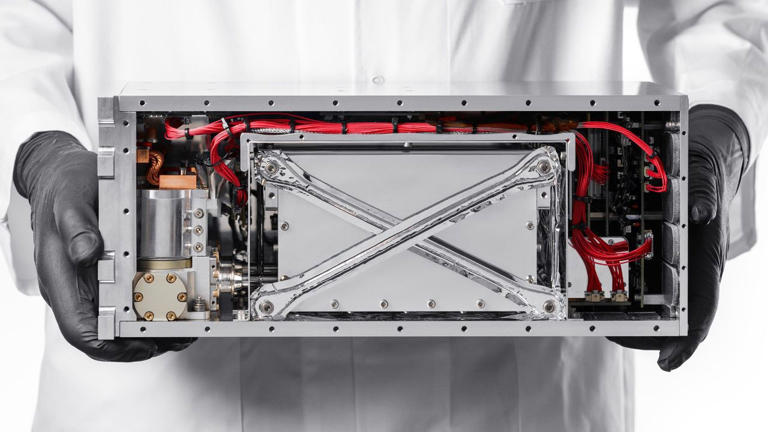

Zenno Astronautics' Superertorquer attitude control system uses superconducting magnets powered by solar energy to generate thrust aboard satellites. The system was recently tested in orbit.

Zenno Astronautics, a spin-off from the University of Auckland, has flown its new "Supertorquer" system on the Mira satellite built by California-based start-up Impulse Space. The tests began shortly after Mira's launch in November last year aboard the SpaceX Transporter 12 mission and saw the shoebox-size device perform with flying colors, Zenno Astronautics CEO and founder Max Arshavsky, told Space.com.

The unit housing the superconducting magnets is wrapped in layers of insulation and fitted with a heat pump that removes all the excess heat from the system. Every time the satellite needs a push, the superconducting coils power up, drawing energy from a battery charged by the satellite's solar panels.
