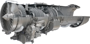

ANKA 3 takes flight with TF 10000 engine made by TEI. Impressive stuff from the Turkish defense industry. It will be a potent platform.
not TF-10.000 .. but TF-6.000
ANKA-3 will use TEI TF-6.000 turbofan Engine
KIZILELMA will use TEI TF-10.000 turbofan Engine
Technical Specifications ... TEI-TF6000 Turbofan Engine​
  • Dry thrust (SLS, ISA): 6.000 lbf
  • Dimensions: 860x1100x2250mm
  • By-pass Ratio (SLS, ISA): 1,08
  • Specific Fuel Consumption (lbf/lbs.h): 0,70
  • Configuration
    • Fan: 2 stage axial
    • Compressor: 6 stage axial
    • Turbine: 1 stage HPT - 1 stage LPT
    • Combustion Chamber: Through Flow

Technical Specifications ... TEI-TF10000 Turbofan Engine​
  • Thurst (SLS, ISA): 6.000 (Dry) / 10.000 (Wet) lbf
  • Dimensions (WidthxHeightxLength): 870x1150x3150mm
  • Configuration
  • Configuration
    • View attachment 20934
