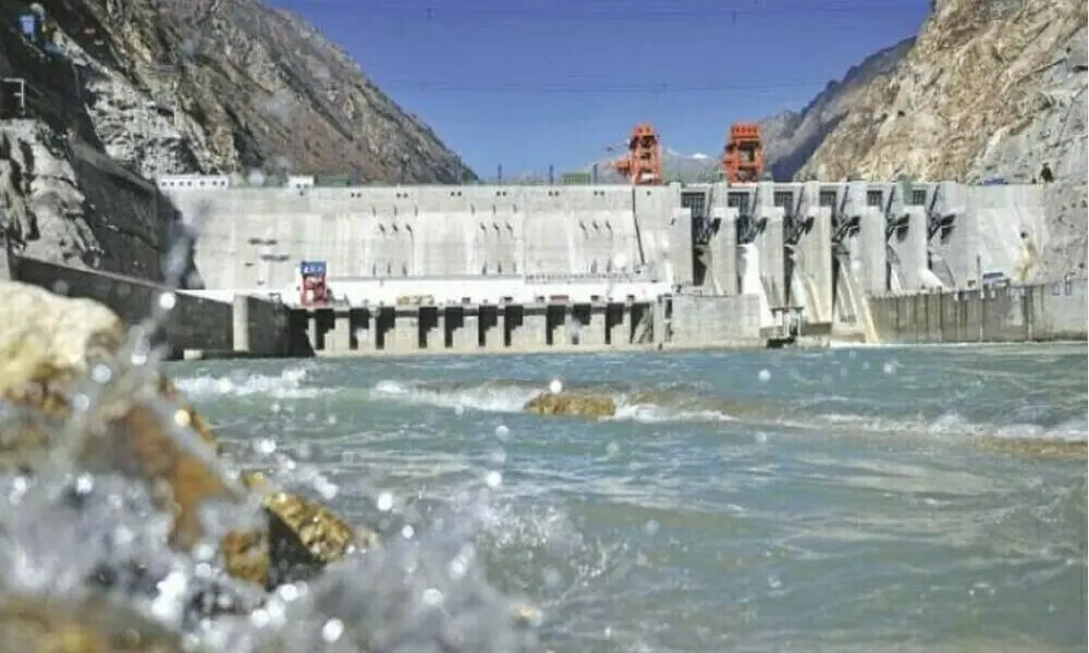

DASU HYDROPOWER PROJECT | 4,320MW
The construction of the 4,320 MW Dasu Hydropower Project continues to mark important progress toward transforming Pakistan’s energy landscape.
Developed in two stages, the project is expected to generate approximately 21 billion units of clean, affordable electricity annually upon completion, strengthening the national grid and supporting Pakistan’s growing energy needs.
Explore the latest pictorial updates showcasing the ongoing construction activities and development of this landmark hydropower project.
Total Planned Capacity: 4,320 MW
Stage-I Capacity: 2,160 MW
Expected Annual Generation: 21 billion units
A major milestone in Pakistan’s clean energy journey
A landmark project for sustainable development and Pakistan’s energy future.
