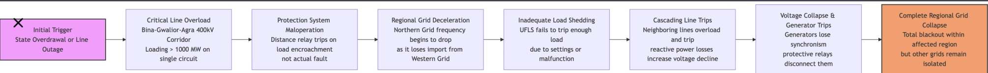

The Vector: The failure of a single, critical node within a regional grid, often combined with pre-existing stress.
Detailed Walkthrough:
This scenario represents a more severe cascading failure where the initial event propagates across interconnected regional grids. The July 31, 2012 blackout is the prime example, affecting over 600 million people .

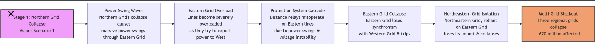

The Vector: A failure in one region cascades into its synchronously connected neighbors, overwhelming their interconnections.

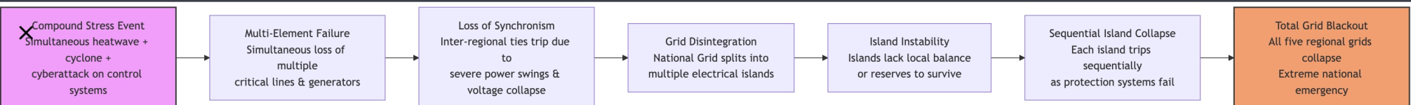

This is the "doomsday" scenario, where a cascading failure becomes a continent-wide collapse. While no event of this scale has occurred in India, it is a theoretical possibility under extreme, compound stresses.
The Vector: A multi-pronged, coordinated attack designed to exploit both synchronous and asynchronous links, or a failure so severe it causes a system-wide frequency collapse.
