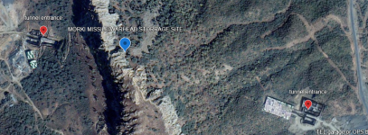

Morki missile and warhead storage site RAJASTHAN
27°57'33"N 75°46'47"E
  1. Has multiple tunnels reaching into the mountain
  2. Has TEL/vehicle garages with high ceiling
  3. Has three different types of fences and perimeters for security
  4. High security year round with large watch towers
Don't come at me cuz my reply wasn't visually appealing
