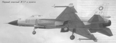

The first six prototypes were produced in 2003 and the aircraft made its maiden flight on 25 August 2003.

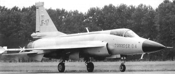

Super-7

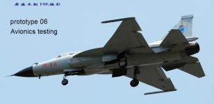

FC-1 prototype
PAF JF-17 Thunder (Block-I)
