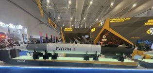

Why This Missile Is a Different Beast Altogether​
Before jumping into numbers, it is worth being very clear about something that gets glossed over in most reporting: the FATAH-II is not simply a bigger version of the FATAH-I. It is a structurally different category of weapon.
The FATAH-I is a conventional Guided Multiple Launch Rocket System (GMLRS) — it fires a solid-fuel rocket that follows a ballistic arc to its target, guided throughout by INS/GNSS. Think of it like a very large, very precise mortar round.
The FATAH-II occupies a different category entirely. Multiple independent defence publications, drawing on GIDS's own marketing language ("non-ballistic, all-course manoeuvre, supersonic"), describe the missile as employing some form of post-boost aerodynamic flight after its solid rocket motor burns out. Some analysts specifically interpret the post-boost behaviour as involving a separating glide vehicle — a lifting body that detaches from the spent motor casing and flies itself to target under aerodynamic lift at supersonic speed. This interpretation appears in credible open-source defence coverage and is consistent with GIDS's "non-ballistic, supersonic" language, though it has not been explicitly confirmed by GIDS as a description of physical stage separation.
However, GIDS has not published a detailed technical datasheet explicitly confirming a separating glide vehicle as a discrete component. The architecture is therefore best treated as the most widely held analyst interpretation of the available description, not a formally confirmed factory specification. This distinction matters because the entire glide-phase range contribution in Step 4 is contingent on that architecture being correct. Where it drives the analysis, the glide-vehicle assumption is flagged explicitly.
This document examines both the propulsion performance common to all plausible architectures and the additional range contribution if the analyst-described glide phase is accepted, along with what either scenario implies about the missile's kinematic ceiling.
What Is Actually Confirmed​
Sources differ in some particulars, but the following specifications are either directly confirmed by GIDS official documentation or corroborated across multiple independent defence publications:
ParameterConfirmed ValueSource
Length7.5 mGIDS / Janes / EDR Magazine
Body Diameter~600 mmQuwa
Warhead Mass365 kgGIDS official data sheet
Warhead TypeUnitary blast / blast-fragmentationGIDS
PropulsionSingle-stage dual-thrust solid rocket motorJanes / Army Recognition
Post-boost behaviourSupersonic flight at Mach 2+ after motor burnout; some analysts interpret this as involving a separating glide vehicle, but physical stage separation has not been confirmed by GIDSQuwa / Army Recognition / EDR
Official Domestic Range400 kmISPR
GIDS Export Range (datasheet)100–290 kmGIDS / WDS 2024 documentation
GuidanceINS + multi-constellation GNSSGIDS
CEP (manufacturer)≤50 mGIDS
CEP (ISPR claim)<10 mISPR
Terminal speedMach 2+Multiple sources
Launcher2-round canister, Taian TAS5450 8×8 TELJanes / Euro-SD

Two figures that remain publicly undisclosed — and which matter enormously to the analysis — are the total launch mass and the motor's propellant load. Everything below that requires those numbers will be estimated.
Step 1 — Estimating Launch Mass​
Since GIDS has not published a total launch mass for the FATAH-II, the starting point is geometric scaling and structural analogy.
At 600 mm diameter and 7.5 m length, the FATAH-II's volume is roughly four times greater than a 300 mm rocket of comparable length. Structural mass scales somewhat less than linearly with volume (thicker walls, but proportionally lighter), while propellant mass scales with internal volume. Cross-referencing against publicly documented systems of similar calibre and mission:
  • The Chinese DF-12 (600 mm, ~7.3 m): estimated launch mass 1,500–1,800 kg
  • The American ATACMS Block I (610 mm, ~3.96 m): 1,672 kg total, 560 kg warhead
  • The Russian Iskander-M (920 mm, 7.3 m): 3,800 kg — illustrates that diameter scales mass rapidly
FATAH-II's confirmed 365 kg warhead, combined with estimated guidance electronics (~50 kg), airframe, control surfaces, and guidance section (~130 kg), and motor hardware/casing (~90 kg), yields an inert mass of approximately 635–660 kg.
Using a propellant mass fraction consistent with modern tactical solid-fuel missiles (60–65%), the resulting total launch mass estimate is:
ParameterEstimate
Total Launch Mass~1,400–1,900 kg (central value: ~1,600 kg)
Propellant Mass~860–1,140 kg
Inert / Dry Mass~540–760 kg
Mass Ratio (M₀/M_f)~2.4–2.8
These are engineering estimates with substantial uncertainty. The wider range reflects how little dimensional and structural data is publicly confirmed. They are not manufacturer figures, and the central value of ~1,600 kg is used for illustrative calculation only.
Step 2 — The Dual-Thrust Motor Explained​
The "single-stage dual-thrust" description from GIDS is specific and worth unpacking because it directly shapes the trajectory.
A dual-thrust motor contains two propellant grain sections within a single casing. The boost grain burns first — high thrust, short duration — accelerating the missile rapidly to high velocity. The sustain grain then takes over at lower thrust, maintaining velocity through the atmospheric drag zone without expending propellant at the expensive rate needed for initial acceleration.
This architecture achieves two practical things:
  1. It extends powered flight time, giving the guidance system more window to correct the trajectory during the energised phase.
  2. It produces a flatter trajectory at lower altitudes during the sustain phase — consistent with GIDS and independent analyst descriptions of the FATAH-II as having a "quasi-flat" flight profile.
The tradeoff is thermal efficiency. Running two different burn rates from one casing is less mass-efficient than optimised sequential staging. The FATAH-II accepts this penalty in exchange for the tactical advantage of low-altitude radar evasion during the powered phase.
Modern dual-thrust motors of this class achieve specific impulse (Isp) values in the range of 248–260 seconds, consistent with high-energy aluminised HTPB-based composite propellants. Using 255 seconds as the working value:
Ve = Isp × g0 = 255 × 9.81 = 2502 m/s
Step 3 — Ideal Delta-V (Boost Phase)​
Applying the Tsiolkovsky Rocket Equation to the boost phase, using the central mass estimate (MR ≈ 2.63):
ΔV₍ideal₎ = Vₑ × ln(M₀/Mf) = 2502 × ln(2.63) = 2502 × 0.967 ≈ 2419 m/s
The Tsiolkovsky equation estimates only the propulsion-derived velocity increment. It does not by itself determine missile range, which also depends on trajectory, atmospheric drag, aerodynamic lift, and guidance. Those factors are addressed in the steps that follow.
Across the full launch mass uncertainty range (MR of 2.4–2.8), ideal ΔV spans roughly 2,175–2,575 m/s — a spread of ~400 m/s driven primarily by how much propellant mass fraction the missile actually carries. Real flight is messier than that. For a quasi-ballistic missile like the FATAH-II flying a relatively flat trajectory (which increases time in the dense lower atmosphere compared to a high-loft profile), estimated losses are:
Loss CategoryEstimated Magnitude
Gravity losses (cosine losses along lofted arc)350–550 m/s
Aerodynamic drag during powered flight200–400 m/s
Guidance/trajectory correction budget50–100 m/s
Total losses~600–1,050 m/s
This yields an estimated burnout velocity of approximately 1,370–1,820 m/s — corresponding to roughly Mach 4.0–5.3 at the burnout altitude. Terminal speed is lower than burnout velocity because aerodynamic drag continuously dissipates kinetic energy throughout the descent phase, decelerating the vehicle significantly before impact. The reported Mach 2+ terminal figure is consistent with this picture.
Step 4 — Flight Architecture and Range: Two Scenarios​
This is where the analysis must be most explicit about what is known versus inferred, because the architecture assumption determines the range mechanism entirely.
Scenario A — Separating Boost-Glide Architecture (Analyst-Described)​
Several credible open-source publications, citing GIDS's "non-ballistic, supersonic, all-course manoeuvre" description, interpret the FATAH-II as having a separating glide vehicle: the spent motor casing jettisons after burnout, and an aerodynamic lifting body continues flight under its own control surfaces. If this architecture is correct, the range breakdown becomes two distinct contributions.
For a pure ballistic (non-lifting) trajectory from the estimated burnout conditions, the boost phase alone would reach approximately 250–300 km under vacuum, less in atmosphere. The glide vehicle, if present, would extend this by maintaining aerodynamic lift during descent.
The glide contribution depends on the glide vehicle's lift-to-drag ratio (L/D) at supersonic speeds (Mach 2–4 during descent):
  • Simple finned body: L/D ≈ 1.5–2.5
  • Shaped lifting body with active canards: L/D ≈ 3.0–5.0
The GIDS "all-course manoeuvre" description implies active control surfaces throughout flight, suggesting something closer to a lifting body than a passive nose cone. An L/D of approximately 3.0–4.0 is a defensible estimate if the architecture is confirmed, but this carries significant uncertainty. Using these representative supersonic L/D values (approximately 3–4), estimated separation altitudes on the order of 30–40 km, and allowing for aerodynamic losses during the descent, the glide phase could contribute approximately 80–140 km of additional range, producing a total that is broadly consistent with the official 400 km figure.
Important caveat: The specific figures above (80–140 km glide contribution, 355–435 km total) are internally consistent only if the separating glide vehicle architecture is real. They should not be read as a confirmed decomposition of the missile's range. They are what the math produces under a specific architectural hypothesis.
Scenario B — Unified Quasi-Ballistic Architecture​
If the FATAH-II instead operates as a single unified body — the motor burns out and the complete airframe (warhead + guidance + fins, still integrated) follows a quasi-ballistic arc without physically separating — then the range mechanism is purely ballistic with aerodynamic shaping for manoeuvring.
Under this scenario, reaching 400 km may require a higher burnout altitude, a more efficient trajectory, or more favourable propulsion parameters than assumed in this analysis — which is one reason many analysts lean toward Scenario A as one plausible physical explanation.
What Both Scenarios Agree On​
Regardless of architecture, a missile of this size, propellant fraction, and motor performance can plausibly reach the 350–450 km range band under some combination of propulsion, trajectory, and aerodynamic configuration. The official 400 km claim is technically credible under either scenario. The mechanism differs; the destination does not.
Step 5 — Upper Bound: What Lies Beyond 400 km​
The official 400 km is almost certainly not the absolute physical limit. The question is how far above it the kinematic ceiling sits — and whether the available open-source data are sufficient to quantify that ceiling confidently. They are not.
What can be said with reasonable confidence is that several operational constraints actively reduce range below the physical maximum:
Trajectory profile. The FATAH-II is deliberately designed to fly low and flat to compress radar detection and interception windows. This is tactically sound but aerodynamically inefficient — a higher loft angle would reduce time in dense atmosphere and extend range, at the cost of becoming a more predictable and earlier-detected target.
Manoeuvring overhead. The "all-course manoeuvre" capability requires control surface deflection throughout flight, which adds induced drag and consumes energy that would otherwise go into range extension. A passive ballistic trajectory would be more efficient.
Standard payload constraint. Range figures are quoted with the operational 365 kg warhead. A reduced-payload configuration would mechanically extend range.
Operational validation margin. Stated ranges reflect the tested, qualified operational envelope — not the boundary of what the physics allow.
These factors collectively suggest a theoretical kinematic ceiling somewhat above 400 km exists under optimised conditions (higher loft angle, reduced manoeuvrability, reduced payload). However, the available open-source data are insufficient to determine a reliable numerical upper limit. Deriving a specific figure would require assumptions about trajectory optimisation that cannot be validated without access to the motor thrust profile, drag coefficient, and trajectory modelling — none of which are publicly available.
A 20–35% margin above operational range is sometimes cited as typical for systems of this class, but applying that rule of thumb here would be substituting an analogy for a derivation. It is not done in this analysis.
BSP_104031-JDW-35817.jpeg​
The MTCR Question — Why 290 km for Export​
One of the most telling numbers in the open-source record is not 400 km. It is 290 km — the range ceiling on GIDS's own official export product datasheet.
The Missile Technology Control Regime (MTCR) draws its most sensitive line at 300 km range with 500 kg or greater payload. Systems meeting both criteria fall into Category I, the strictest tier of export controls. Pakistan is not a formal MTCR signatory, but it is sensitive to international proliferation norms and keen to preserve its access to dual-use technology.
The FATAH-II's 365 kg warhead sits below the 500 kg Category I payload threshold. However, systems capable of 300+ km range can invite Category I scrutiny regardless of declared payload weight if they are assessed as potentially capable of WMD delivery. By capping the export variant at 290 km, GIDS keeps the system unambiguously below the 300 km range trigger on the MTCR spectrum, making it a cleaner export without requiring individual case-by-case reviews under the most restrictive protocols.
The domestic 400 km variant is retained as a Category I item for Pakistan's own forces, consistent with its role as a deep-strike conventional deterrent under the Army Rocket Force Command.
Comparison With Analogous Systems​
SystemCountryDiameterPropulsionOfficial RangeType
GMLRS (M31)USA227 mmSingle-stage solid84 kmGMLRS
ATACMS Block IUSA610 mmSingle-stage solid~300 kmQuasi-ballistic
Iskander-MRussia920 mmSingle-stage solid500 kmQuasi-ballistic
DF-12 (M20)China600 mmSingle-stage solid280–400 kmQuasi-ballistic
FATAH-IPakistan300 mmSingle-stage solid140 kmGMLRS
FATAH-IIPakistan~600 mmDual-thrust solid rocket; post-boost glide reported by analysts400 kmQuasi-ballistic
The DF-12 is the most structurally similar public analogue, sharing comparable diameter and range band. The ATACMS Block I provides a useful propulsion reference, though its warhead mass and trajectory profile differ. Unlike both, the FATAH-II emphasises a flat low-altitude approach profile, which trades aerodynamic range efficiency for survivability against radar-guided intercept systems.
Key Uncertainties in This Analysis​
Flight architecture — the foundational uncertainty. Everything in Step 4 depends on whether the FATAH-II actually employs a separating glide vehicle. If it does, the boost-plus-glide range decomposition is meaningful. If the missile operates as a single integrated quasi-ballistic body, the glide L/D calculations are simply inapplicable. This is the single most important unknown and it cannot currently be resolved from open-source information.
Launch mass. The range 1,400–1,900 kg already reflects substantial uncertainty. An error of ±200 kg shifts the ideal ΔV by approximately 6–9% and changes the boost-phase range contribution by a similar margin.
Propellant Isp. The difference between 248 and 260 seconds may seem narrow, but over ~1,000 kg of propellant it moves the ideal ΔV by roughly ±150 m/s — equivalent to 5–8 km of boost-phase range.
L/D ratio of the post-boost body. Under Scenario A, this is the parameter with the greatest single-unit sensitivity on the result. Even one unit of L/D at the estimated separation altitude shifts the glide range contribution by ~25–35 km. And since L/D at Mach 2–4 is not published, any value used is inherently speculative.
Trajectory profile and burnout altitude. The exact launch elevation, dual-thrust motor burn schedule, and burnout altitude all directly determine both boost-phase range and glide efficiency. None of these are in the public record.
The qualitative conclusion — that 400 km is physically credible, and that a kinematic ceiling above it exists but cannot be reliably quantified — is robust to these uncertainties. The specific numbers throughout this analysis are not.
Conclusion​
The FATAH-II is a more complex analytical subject than the FATAH-I because its range depends not just on propulsion performance but on a flight architecture that has not been formally confirmed in GIDS's own published documentation. That distinction matters, and this analysis has tried to treat it honestly.
What the propulsion analysis does establish clearly is that a 600 mm solid-fuel missile with plausible mass fractions and modern composite propellant can credibly reach the 350–450 km range band under a range of reasonable trajectory and architectural assumptions. The official 400 km claim is technically credible. It does not require exotic propulsion or implausible structural assumptions to achieve.
The question of whether the FATAH-II possesses a kinematic envelope meaningfully above 400 km is real and reasonable. The operational trajectory choice, manoeuvring overhead, and standard payload constraint all suggest some headroom exists. But the available open-source data are insufficient to quantify that ceiling reliably. Any specific numerical upper bound — including figures that have appeared in other analyses — should be understood as an analytical hypothesis rather than a derived engineering result.
The same caveat applies to the glide-vehicle architecture itself. Multiple credible open-source publications describe a separating boost-glide configuration, and it is one plausible physical explanation for how the missile achieves 400 km from a flat-trajectory profile with a modest propellant load. But until GIDS publishes a technical breakdown that explicitly confirms the separation mechanism, that description remains the most widely held analyst interpretation, not a formally confirmed characteristic.
The official 400 km domestic range remains the only validated, publicly stated capability. The 290 km export ceiling is a deliberate MTCR-sensitivity decision, not a physical constraint. And the 110 km gap between them is, as noted throughout, one of the most informative signals in the publicly available record.
This analysis is an open-source engineering exercise using publicly available information, standard propulsion equations, and stated engineering principles. No classified information was used or implied. Corrections, alternative calculations, and additional public data from those with relevant expertise are welcome — particularly on the flight architecture question, where the open-source record remains genuinely incomplete.
All figures rounded to significant digits consistent with the uncertainty of the underlying estimates. Mass fractions, Isp values, aerodynamic coefficients, and trajectory parameters are engineering assumptions, not measured or manufacturer-confirmed values. The glide-vehicle L/D analysis in Step 4 (Scenario A) is contingent on the separating glide vehicle architecture being correct and should be treated accordingly.
