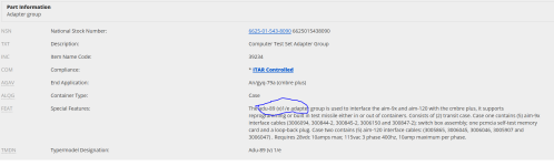

Close, but something even more specific that would require the AN/APG-83 to fully work. There's no reason for us to get it (and we are) for just the Link-16. Basically, the ADU-891, which is necessary for AIM-120C8/9 and AIM-9X Blk2.
