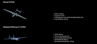

Funny you should say that. For a very long time I suffered from the Mandela effect and misremembered S3 having boom-mounted twin engines like the Aksungur.
I understand the desire to have commonality with S2 in terms of design by having a single pusher in the fuselage but seeing the roles S3 is envisioned for perhaps a better design would've been boom-mounted twin engines. Yes, I know this would increase size, weight, and complexity, but in my naive opinion in the absence of super-powerful engines, this was the logical choice.
EDIT: So logic dictates that S3 is being pushed around before an appropriate engine has been installed and more importantly GIDS is confident that this engine will come (I hope), and hence the design choice.
are you sure you're misremembering, because i also have the same memory lol... gids road to future, i feel like it was scrubbed.
Yes, it turned out it was S4 or something but I was thinking it was S3 lol.

Not Mandela effect. You just misremember the group 5 UAV that was shown on GIDS road to future page and has since been removed.

Thanks to wayback machine:
Both weight classes have their own uses. 170hp S3 is tailor made for COIN operations unlike akinci types which can be overkill and expensive as a workhorse. S3-170, Six hard points, two dual racks, can carry 4 burq50p (200kg) and 4 Burq25g (100kg) with a 100 Kg of external payload still to go. Enough to decimate a tashkeel of 50 or more without losing a single soldier.
The twin engine (basically like askungur) will be perfect for maritime operations and long range ISR. Better range and payload to haul torpedoes and endurance to loiter and find the Subs. Etc.
The single engine needs to be the COIN workhorse and will be cheaper to fly. Outperforms Ch-4b and TB2 types currently on paper atleast. Give it a better engine like PD-222 eventually and we can get 500 kg of external payload. Enough for 2 (Pk82) or 4 (pk81) general purpose bombs if micro munitions don't cut it.
