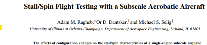

A. No. Please read my posts - I've explained in a lot of detail, why wind tunnels only provide limited data on spin testing. And that too requires special wind tunnels. If wind tunnels were all you needed why are aircraft as modern as F-35 doing spin testing:
That's a spin chute for recovery from spin when control system fails. Spin testing is done to develop procedures for escaping spin.
B. It is not a toy. But if you insist on calling it a useless toy, I can't convince you otherwise.
Again, please skim through the pdf I shared on scaled flight testing. I'm sorry but I can't possibly give a lecture on aircraft scaled flight testing on a forum. I cannot believe I have to convince you of the utility of this when we see scaled flight testing for all sorts of programs.
Also, you really don't know who you are talking to on a forum, which goes both ways of course - you could be the world expert on scaled flight testing. But lecturing me about AutoGCAS is amazingly ironic. @Quwa lol.

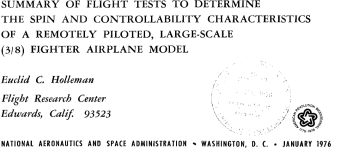

To respond to your nonsense in case somebody else sees it. Here's a few documents detailing how various agencies did spin testing on R/C models - finding this took 3 seconds on google. So very clearly you just want to win the argument and care nothing about the truth.
You very OBVIOUSLY know very little about scaled-flight testing and keep harping on about representative speeds. My brother, the speeds are scaled through scaling laws and Iqbal is designed to achieve those speeds. Even if you were totally ignorant you could've skimmed through the pdf I shared but very clearly your ego won't let you be wrong.
Also, you have grabbed on to spin testing and totally ignored everything else that I listed as missions for Iqbal. Spin testing was just ONE POSSIBLE missions out of TEN I listed. This is more evidence that you are here for a pissing contest. I'm sorry it is obvious to me that you are arguing to win and not to learn. Welcome to my ignore list.
