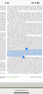

Looks like AMCA will have 1394 databus, rather than 1553.
And as they going for DDFBW, 1394 is almost certain.
What does that mean? Is it advantageous or otherwise? Can you elaborate?
Providing higher data transfer than current gen. In simple terms, MC/sensors/LAD going to based on optical fiber rather than current copper.
