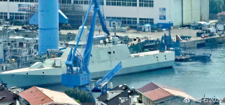

Photos of the modified Type 022 missile boat.
The rear missile launch system was removed and replaced with a platform.

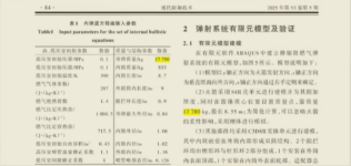

Reports indicate that China has developed a new generation of large vertical launching systems (VLS).
Maximum missile weight that can be launched: 17.78 tons
Maximum missile length that can be launched: 8.7 meters
Maximum missile diameter that can be launched: 0.84 meters
Internal diameter of the VLS: 1.02 meters
It is primarily used for launching large hypersonic missiles.
It is reported that the VLS has completed relevant tests on a test ship.

For example, this document. So, how much of this can you understand?
