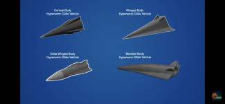

1000051779.pngfor reference not all hgv look the same. There are different types

A truly advanced hypersonic missile possesses an aerodynamic shape with a high lift-to-drag ratio (such as a waverider), sustained scramjet propulsion, and extensive lateral maneuverability. This necessitates the coordination of thrust, thermal protection, and flight control systems, and cannot be achieved merely by adding four small winglets, as India has done.
As I thought, our neighbours only consider waverider and blended body as HGV but by that standard - the dark eagle of usa is also not an HGV but I don't see you guys arguing if dark eagle is hgv or not.
