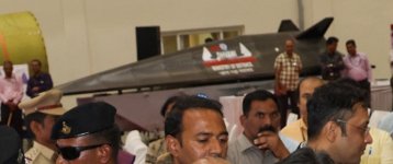

1000052099.jpgand I stopped arguing about LR-AShM being HGV, since another HGV (project dhvani) will hopefully be tested this year and it's blended body hgv so they won't argue this time. The above photo is the only available photo of Dhvani. If they don't believe LR-AShM is HGV then it's their warships that will pay the price for their own stupidity and denial

View attachment 195966and I stopped arguing about LR-AShM being HGV, since another HGV (project dhvani) will hopefully be tested this year and it's blended body hgv so they won't argue this time. The above photo is the only available photo of Dhvani. If they don't believe LR-AShM is HGV then it's their warships that will pay the price for their own stupidity and denial
