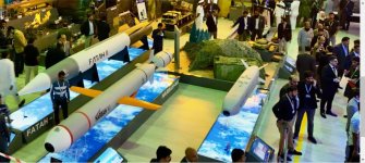

Fatah -2
Twin Cannister Oblique launched
Non Ballistic
All Course Maneuver Weapon System
Single Stage - Dual Trust Solid Rocket motor
Salvo - Non Salvo
Auto Aiming
In flight Guidance till impact
Claiming Ballistic Missiles as Guided Rockets
"While traditional rockets lacked inherent guidance systems, numerous countries have successfully developed and deployed guided rockets equipped with INS/GPS guidance for precision strikes, just like ballistic missiles. Notable examples include the American GMLRS (HIMARS), Russian Tornado-S, and Israeli Extra, which boast ranges between 70 km and 150 km.
Although both guided rockets and ballistic missiles utilise INS/GPS guidance, they exhibit significant differences. Guided Rockets are characterised by their compact size, substantial firing power (typically 6-10 rockets per launcher), and limited range compared to ballistic missiles. However, ballistic missiles, with their extended strike ranges and reduced firepower, offer a strategic advantage in certain military operations, typically deploying 1 or 2 missiles per launcher.

The success of rocket artillery systems in the war can be capitalized on by GIDS through its own offerings as militaries around the globe closely monitor efficacy of platforms in the war, as seen from the booming market for the TB-2 UCAV and Kamikaze drones. FATAH-1 and 2 have high export potential for Pakistan due to relatively lower cost than western MLRS systems, however, provide saturated firepower, high precision and can engage enemy installations, personnel and high value assets at standoff ranges."
“Equipped with a state-of-the-art navigation system, unique trajectory, and manoeuvrable features, Fatah-II is capable of engaging targets with high precision and defeating any missile defence system, “Fatah-II is being inducted into Pakistan’s Artillery Divisions for standoff, precision engagement of deep targets. The rocket system will significantly upgrade the reach and lethality of Pakistan Army’s conventional arsenal,” said the Inter-Services Public Relations (ISPR), the public relations wing of the Pakistan Armed Forces
Short-range ballistic missiles such as India’s Pralay, Russia’s Iskander-M, and US Precision Strike Missiles offer strike ranges of 500 km with two missiles per launcher. The Fatah-II’s launcher configuration also reveals the presence of two missiles. Thus, based on these characteristics, the Fatah-II should be classified as a short-range ballistic missile rather than a guided rocket.

Fatah -2
Non Ballistic
Salvo - Non Salvo
Auto Aiming
It was reported that fateh2 has a range of 400km or 450km but not 280km as in the poster
