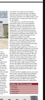

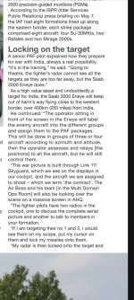

This from air force monthly at one point he says that my radar is locked on the target and than says target info is fed through DL.
So what is it actually?.

Radar on or just the aircraft using it's datalink to directly communicate with missile
View attachment 178143View attachment 178145View attachment 178144
I guess the Erieye had a Lock, but that was not taken as a threat as it was an AWACS flying too far.
That info was passed on to the jets , which fired the PL-15 and without a Lockon by the jet .
Since none of the PAF jets had a Radar Lock on Indian jets, they did not break the formation and did not take any evasive measures.
The PL-15 reached the target area then switched on its AESA radar, which was detected by Rafale RWR, and by then it was too late. The PL-15 must have lock on the Rafale , gone " Kutta" and hit the target.
that will mean that SAAB Erieye is integrated with J-10CE and than it also brings another question why JF-17B3 didnt get fired its PL-15 if it has to be guided by SAAB Erieye?
Integrated via Link 17, which is a Ground based Translator.
The Allen Warnes article posted above also mentions Indigenous encryption , which may also explain how Erieye can also talk to PL-15 , and PAF assumes it safe. Because if any other aircraft can talk to a missile fired from another aircraft, chances of that missile being hacked are imminent . But PAF apparently is confident about their signal encryption , integrity , and allows offboard targeting and guidance .
About why one aircraft was used in a certain role and why not another? It depends on PAF war plan, which are pre existing, with designated roles to each type of aircrafts.
I am assuming J-10C carries the longest range PL-15, while JF-17 carries SD-10 .
We are entering the era of quantum computing, so the idea of encryption keys being "safe" will disappear into history until/unless quantum safe encryption keys can be developed, or there is constant changing of keys, such that you can be sure they are secure for a period of time. Additionally, maybe move into a model where each plane can have its own encryption keys etc ( i wont go into it, it is topic in itself.).
J-10 Acts as data aggregator then passes info to PL-15. This is similar to discussion made earlier on JF-17 thread.
J-10 mission computer is basically fed through the Mil STD bus messages, its Sensor/Data fusion module creates a picture of the target information which it then feeds through the messages it needs to send to PL-15 on where the target is.
No source code required.
JF-17 can't stay at 40000 ft for long, so it flies at 30000. This reduces range of PL-15, even if it is guided by some other asset.
