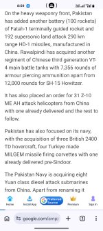

According to an article by Hindustan Times on January 26, 2026 Pakistan has acquired 192 HD-1 supersonic cruise missiles from China.
