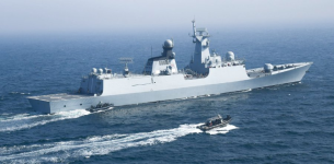

Pakistan Navy's Type 054A/P (TUGHRIL) Class Guided Missile Frigate operating somewhere in the North Arabian Sea.
If the PN ships don’t have them, they should really look into getting inflatable decoys. The PLAN is starting to field them in growing numbers on their destroyers.
