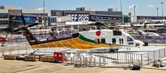

newest t129 with ASELFLIR 410 and turkish cannon
It looks much better now. The redesign was good.
The first one was designed to be like the S-92
with a ramp in the back.
but they have gone back to the S-70 style.
I think they should put it into production straight away, and not wait for the domestic engine, and start production with the T700-TEI-701D thats being license built for the previous T-70 contract. Then when the engine is ready, swap the new engine into the production.
