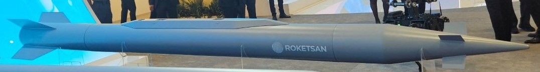

Roketsan 300-ER air launched Ballistic Missile
Range : 500+ km
Speed : supersonic
Length : 5 m
Diameter : 370 mm
Weight : 900 kg
Guidance : GNSS + INS + TV Camera seeker
UCAVs and Fighter Jets will carry 300-ER air launched Ballistic Missile
Unique in NATO
70+ km IHA-122 supersonic Missile
150+ km IHA-230 supersonic Missile
500+ km 300-ER supersonic Missile
good luck to enemy Air Defense Systems
Range : 500+ km
Speed : supersonic
Length : 5 m
Diameter : 370 mm
Weight : 900 kg
900 kg missile has 500 kg range, must be one hell of a propellent, Color me skeptical 🤔
Physics, bro.
Calculate the Isp of the missile's SRM by yourself bro and then comeback later to me.
Even the most lightweight ALBMs with similar range weigh around 1.5 tons, so do tell me what sort of physics is happening here.
Even if we assume a 100 kg warhead and rest of the 800 kg as fuel you still wouldn't have the required Isp to reach 500 km
Okey, since I don't know that much about math and physics, I asked a friend who does. (Chatgpt) :LOL:
The claim that a 900 kg, 5-meter long, 370 mm diameter air-launched ballistic missile like the Roketsan 300-ER can reach 500+ km is actually technically sound. Here's a simplified breakdown of the physics and engineering behind it:
📌 1. Fuel Volume & Mass:
A cylinder of 5 m length and 370 mm diameter has a total volume of about 0.538 m³. Assuming roughly 60% of the internal space is fuel, that's around 0.32 m³ of solid propellant. With an average solid propellant density of ~1700 kg/m³, that gives us about 540 kg of fuel.
📌 2. Specific Impulse & Delta-V:
Typical solid rocket motors have a specific impulse (ISP) of ~220 seconds, which corresponds to an exhaust velocity of around 2158 m/s.
Using the Tsiolkovsky rocket equation:
ΔV=2158⋅ln⁡(900/360)≈2000 m/s\Delta V = 2158 \cdot \ln(900 / 360) \approx 2000 \, m/sΔV=2158⋅ln(900/360)≈2000m/s
So this missile is capable of delivering approximately 2000 m/s of delta-v, assuming a dry mass of 360 kg.
📌 3. Ballistic Performance:
At 2000 m/s, a missile launched at optimal angle in near-vacuum conditions (which is achievable from high-altitude air-launch) can easily reach 500 km or more in range. Air-launch offers significant benefits:
  • Higher starting altitude (less drag)
  • Initial velocity boost from carrier aircraft
  • Reduced fuel expenditure during boost phase
📌 4. Real-World Comparison:
For perspective, the Iskander-M missile weighs around 4 tons and reaches ~380 km from ground launch. The 300-ER, being much lighter and launched from altitude, gains a major efficiency advantage despite using similar solid-fuel propulsion.
✅ Conclusion:
A 900 kg, air-launched ballistic missile reaching 500+ km is not only plausible, but expected with the right design. The skepticism likely comes from comparing this system to heavier, ground-launched missiles, which is not a valid baseline for an air-launched optimized platform.
Gel fuel based AAMs, Are you sure about this
I didn't call Gökhan an AAM. Their lengths and diameters are very different. Gökbora is approximately 3.75 meters, while Gökhan is approximately 5 meters. Like Brahmos, Gökhan is an anti-ship missile.
Initially, it was thought that the technology used in Gökhan could also be used to develop an AAM missile. Later, it became clear that this wasn't possible, and the Gökhan project was launched.
As for crystallization, I believe a solid catalyst containing nanoparticle boron is mixed into the gel. This additive prevents crystallization while also facilitating combustion.
