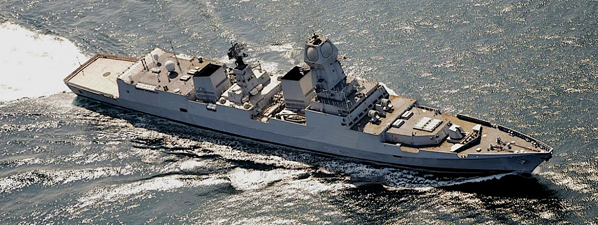

Can you see where the integrated aperture antenna is?
