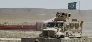

As for using vehicles as checkpoint garrisons, well, unless you can plant a pre-fab semi-permanent concrete bunker down by the roadside, some vehicle eventually have to be there to establish presence while still having mobility. For lower threat areas anti-IED vehicles offer low upkeep cost and light maintenance burden which makes them irreplaceable.
The most usual weapon and tactics employed in ambushing checkpoints like these would be light MLRS and/or mortar shelling, in which case anti-IED vehicle does offer enough protection against shrapnel most of the time. If they are insufficient, like I mentioned before, armoured wheeled IFVs like VN-1 and VN-22 do exist, providing all-round protection ranging from STANAG 4569 III to V depending on the configuration
