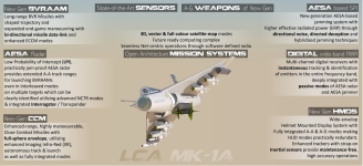

Everyone, please keep providing updates on the specifications of the Tejas MK1A. So far,
  1. the combat range for the Tejas is over 740 kilometers, compared to the F-16's 550 kilometers.
  2. The total range for the Tejas exceeds 3000 kilometers, while it is 2027 kilometers for the F-16.
  3. Both aircraft have 9 hardpoints.
The only advantage the F-16 has over the Tejas is its payload carrying capacity; the F-16 can carry 7.7 tons, while the Tejas can carry 4 tons. However, considering the size of both fighter jets, the Tejas is superior to the F-16 even in this aspect.

Incorrect, Block 70/72's databus and especially EW suite is far more superior than MK1A.
Furthur, I wont go into comparing combat endurance.
How? Explain
Copy pasting from my previous replies
Databus :- The databus used by F-16 Block 70/72 is 1553, but for integrating with radar Lockheed have used ethernet based databus for providing high resolution SAR images to Center Pedestal Display.
As we know Mk1A use 1553 databus for all connections. While LCA Mk2 will use ethernet based databus for all data tranmissions, including Radar, IRST,LDP, HMDS, and even SDR for D/L.
For EW suite, Block 70 use Viper Shield, where it is deeply integrated with active modes of SABR, in which active modes of jammer able to work with active modes of radar. The capability is similer to EPAWSS.
The testing included continuously exposing Viper Shield with APG-83 energy for more than 12 hours to test whether the radar pulses would interfere with EW functionality. The test proved Viper Shield’s ability to filter out signal processing streams from the APG-83 radar pulses without any performance compromise.
While in Tejas Mk1A, Jammer and RWR is only integrated with passive modes of radars.
Viper Shield is almost generation ahead than EW suite of Tejas Mk1A, we achieve it might be in LCA Mk2, but not right now.

I believe Tejas mk1a has 7 hard points only, with 2 of them being wet
As far as payload is concerned
Some reports point to a improved payload capacity of 5300 kg in MK1A
mainly due to weight reduction on account of greater use of composite material
