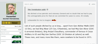

GENERAL AKHTER HUSSAIN MALIK LETTER TO GENERAL ABDUL ALI MALIK
My Dear brother,
I hope you and the family are very well. Thank you for your letter of 14 Oct. 67. The answers to your questions are as follows:
a. The de facto command changed the very first day of the ops [operations] after the fall of Chamb when Azmat Hayat broke off wireless communications with me. I personally tried to find his HQ [headquarters] by chopper and failed. In late afternoon I sent Gulzar and Vahid, my MP [military police] officers, to try and locate him, but they too failed. The next day I tore into him and he sheepishly and nervously informed me that he was ‘Yahya’s brigadier’. I had no doubt left that Yahya had reached him the previous day and instructed him not to take further orders from me, while the formal change in command had yet to take place. This was a betrayal of many dimensions.
b. I reasoned and then pleaded with Yahya that if it was credit he was looking for, he should take the overall command but let me go up to Akhnur as his subordinate, but he refused. He went a step further and even changed the plan. He kept banging his head against Troti, letting the Indian fall back to Akhnur. We lost the initiative on the very first day of the war and never recovered it. Eventually it was the desperate stand at Chawinda that prevented the Indians from cutting through.
c. At no time was I assigned any reason for being removed from command by Ayub, Musa or Yahya. They were all sheepish at best. I think the reasons will be given when I am no more.
d. Not informing pro-Pak Kashmiri elements before launching Gibraltar was a command decision and it was mine. The aim of the op was to de freeze the Kashmir issue, raise it from its moribund state, and bring it to the notice of the world. To achieve this aim the first phase of the op was vital, that is, to effect undetected infiltration of thousands across the CFL [cease-fire line]. I was not willing to compromise this in any event. And the whole op could be made stillborn by just one double agent.
e. Haji Pir [Pass] did not cause me much anxiety. Because [the] impending Grand Slam Indian concentration in Haji Pir could only help us after Akhnur, and they would have to pull out troops from there to counter the new threats and surrender their gains, and maybe more, in the process. Actually it was only after the fall of Akhnur that we would have encashed the full value of Gibraltar, but that was not to be!
f. Bhutto kept insisting that his sources had assured him that India would not attack if we did not violate the international border. I however was certain that Gibraltar would lead to war and told GHQ so. I needed no op intelligence to come to this conclusion. It was simple common sense. If I got you by the throat, it would be silly for me to expect that you will kiss me for it. Because I was certain that war would follow, my first choice as objective for Grand Slam was Jammu. From there we could have exploited our success either toward Samba or Kashmir proper as the situation demanded. In any case whether it was Jammu or Akhnur, if we had taken the objective, I do not see how the Indians could have attacked Sialkot before clearing out either of these towns.
g. I have given serious consideration to writing a book, but given up the idea. The book would be the truth. And truth and the popular reaction to it would be good for my ego. But in the long run it would be an unpatriotic act. It will destroy the morale of the army, lower its prestige among the people, be banned in Pakistan, and become a textbook for the Indians. I have little doubt that the Indians will never forgive us the slight of 65 and will avenge it at the first opportunity. I am certain they will hit us in E. Pak [East Pakistan] and we will need all we have to save the situation. The first day of Grand Slam will be fateful in many ways. The worst has still to come and we have to prepare for it. The book is therefore out.
I hope this gives you the gist of what you needed to know. And yes, Ayub was fully involved in the enterprise. As a matter of fact it was his idea. And it was he who ordered me to by-pass Musa while Gibraltar etc. was being planned. I was dealing more with him and Sher Bahadur than with the C-in-C. It is tragic that despite having a good military mind, the FM’s [Foreign Minister Z.A. Bhutto’s] heart was prone to give way. The biggest tragedy is that in this instance it gave way before the eruption of a crisis. Or were they already celebrating a final victory!!
In case you need a more exact description of events, I will need war diaries and maps, which you could send me through the diplomatic bag.
Please remember me to all the family.
Yours,
Akhtar Hussain Malik

@Joe Shearer @Panzerkiel @Irfan Baloch @SQ8 @arsalan and i dont know who else is interested in this thread. :D
How do you see General Akhtar Malik's untimely removal from the command there during the operation Grand slam and PAK Army's internal rift (general Akhtar Malik VS Major General Yahya Khan and Brigadier Azmat Hayat) that slowed us down and ultimately caused our failure to disrupt vital Indian supply route (Akhnor) to up north!
What's your take on it?
If things would have gone according to GOC 12 Division desires, 12 Division would have veered towards Jammu, with 7 Division going towards Naushara.......Kashmir would have been more or less cut off from mainland India, road Jammu-Samba-Kathua interdicted.....
Losses in Jura and Bedori were negligible when compared with gains in Munawar gap by Grandslam..These losses were expected due to bad troops to space ratio in 12 Division...
however, these losses were still within the limited laid down by Pak GHQ.
In the end, IA committed more forces against Jura and Bedori, while having nothing to counter any Pak thrust towards Akhnur...Two IA brigades had already been pulled out of Jammu...so IA was playing almost as per the needs of Gen Akhtar Malik, GOC 12 Division...
In fact, the full value of Gibralter was have been encashed only after capture of Akhnur, once 12 and 7 Division would have veered towards Naushara and Jammu....if this would have happened, there would have been no Operation Nepal by Indian 1 Corps.
After the war, Malik was posted to an advisory commanding position for CENTO in Ankara, Turkey, where he succumbed to injuries sustained in a road accident on 22 August 1969... In the best traditions of conspiracies in our country... Below is the letter he wrote to his brother before he was killed.
