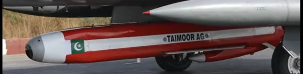

The seeker is the new add on which differentiate the RAAD 2 from TAIMOOR except their commonality with the X-shaped tail fins. The RAAD which was seen carrying by the Jeff had the tail which is peculiar to the RAAD 1. It looked smaller and was on the wing pylon of the jeff so carrying 2 of them is possible..
so raad dnt have i dnt know its seeker in front of its mouth while taimoor has . both have fins and wings . Correct me if am wrong

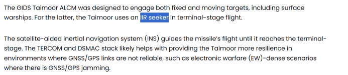

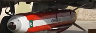

Placement of seeker depends on its type. Because IIR/EO seekers literally see things so they are mounted at nose of missiles be it A2A or A2G. There are many examples. A seeker depended on radar guidance may not be visible but EO/IIR are always visible. If you see the video closely. At the start, Taimoor's seeker is covered but once Mirage start taxing, you can see cover removed. Perhaps that caused confusion.

Ra’ad has a conventional nose radome profile. It does not show an EO/IR-style seeker window at the tip like the Taimur which has been seen with an optical dome. That points to a different terminal guidance approach and different target engagement.
