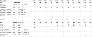

This is how PAFs Air Superiority balance sheet would be looking at the moment, as you can see there is a little breathing room of a couple of years to consolidate:
Key take aways:
1. Additional Rafale acquisitions will need to be met with expedition of J-10 timeline.
2. Jf-17 iterations well positioned to counter balance Tejas acquisitions however high risk options need to be backed up with proven options in order to avoid surprises.
3. Slack present in existing Jf-17 fleet to counter act planned upgrades in Russian origin fleet should IAF efforts bear fruitation.
And this is only a high level platform summary with financials removed, there would be whole optimisation down to munitions level in actual PAF plans. Just to give our future generations a peak.
