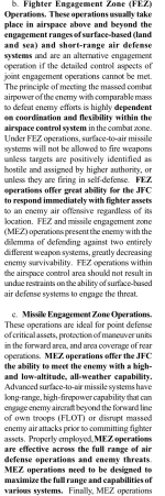

Here is an old US DoD AD procedures https://edocs.nps.edu/dodpubs/topic/jointpubs/JP3/JP3_52_950722.pdf- in a nutshell -
