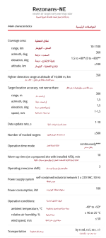

In the export version, Resonance-NE is supplied to other countries of the world. So, the Egyptian Resonance-NE radar tracks the movement of all objects in the airspace not only over Egypt, but also Israel and Syria. According to a number of sources, in 2020 Russia will begin regular deliveries of Resonance-NE to the Middle East. From the beginning of 2020, supplies of the export version of "Resonance-NE" to Egypt began. Iran and Syria are next.
This is the spec sheet released by the Egyptian Ministry of Defense.

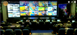

Back in early 2020 when these 2 Rezonance-NE radars were introduced in Egypt and published, there was also news that the EADN was very interested in a 3r Resonance-NE complex to set up in the western desert for the northwest & west territories that encompass the Mediterranean coast and all points west into and beyond the Libyan border. So far there is no published information as to the presence of this 3rd radar.
This is the strategic command & control center located at the immense Bernice Military Base in the south-eastern part of Egypt near the Red Sea where all the aerial traffic of either designation, military or civilian is tracked for its location and movement (vectors) and its position is displayed on the far right screen 24 hrs./day 365/yr.
