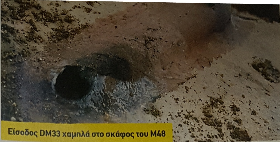

The German sub-division DM-33, which is supported by the M-48 block

On the lower two photographs of the Challenger-2E knotted cannon on the M-48's tower
20170514_190718%2B-%2BCopy%2B%25284%2529
20170514_190718%2B-%2BCopy%2B%25285%2529
Again the M-48's tower and this time through the hamstring - American 120 mm sub-KW-KE-W
20170514_190718%2B-%2BCopy%2B%25282%2529
M-48's tower. M1A12 Type M830A1 HEAT-MP-T Cumulative Sheet
Run from Challenger-2E, the result of the HESH-type shell on the M-48 tower. But it did not break up, but inside the stainless steel "alloy" tanks, the crew had very little chances of survival (although this is the principle of HESH)
