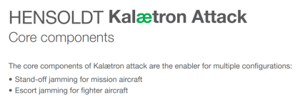

Furthur, Kalaetron is not a standoff jammer, but a ELINT/SIGINT/COMINT platform.

Third, on your point about Kalaetron
Facepalm, Kalaetron Attack and Kalaetron is entirely different platform.
