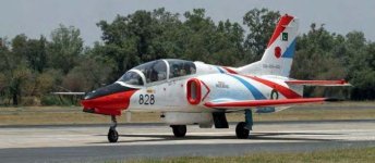

Although acquired as a trainer, the Pakistan Air Force’s K-8P can be fitted with a 23mm cannon in a centreline pack to fulfil a secondary attack role. K-8P serial 08-09-828 serves with 1 Fighter Conversion Unit at PAF Base M M Alam.
Alan Warnes.
The K-8W doesn’t have radar but can provide a useful ‘bang for the buck’ with its five hardpoints. A 23mm gun or laser targeting pod can be mounted on the centreline, while ‘smart’ weapons, such as 50kg or 100kg (110 or 220lb) LS-6 laser-guided bombs, HF-20 rocket launchers and PL-5E or YJ-9E missiles, can be fitted to the outer underwing pylons. The inner pylons can accommodate 6kg, 11kg and 50kg (13lb, 24lb or 110lb) training bombs.
Owing to military sanctions, AVIC only offers K-8s with the Ukrainian Motor Sich AI-25TLK turbofan engine, which has suffered spare parts shortages in the past. Co-developer Pakistan meanwhile operates its K-8P trainers with Honeywell TFE731 turbofans.

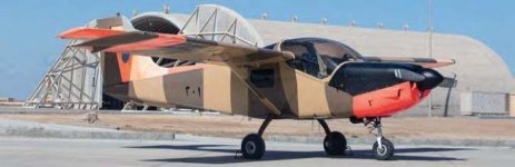

Super Mushshak
The PAF was not too happy about the slow rate of climb of the Mushshak in hot summer temperatures, as students were left with less time aloft to perform their air exercises. This was quite in contrast to the 1973 flight trials, which had been held in the cold November weather, something that had been smartly planned by SAAB, but somehow not seen through by the PAF. Pakistan Army Aviation, used to the STOL capability of the earlier L-19s, was also not impressed with the Mushshak’s take-off performance, especially from unprepared airfields in forward areas. Cruise speed was also a feature that required enhancement.
The need for performance improvements was felt as far back as 1985, when AMF, SAAB-Scania and Teledyne Continental Motors teamed up to retrofit the Mushshak with a more powerful engine. The Continental IO-360 six-cylinder turbo-charged engine, delivering 210 horsepower, was chosen for the ‘Shahbaz’ (‘Royal Falcon’ in Persian), as the modified aircraft was to be known. Work continued for the next two years, incurring an expenditure of US$ 2 million, but the results were far from satisfactory. The failure of the project was largely due to design changes in the basic aircraft that negatively affected stability and balance.
With pilots still unhappy about the performance of the weak 200 horsepower engine, the power plant retrofit project was revived in 1995. A strict stipulation not to meddle with the basic design of the aircraft was laid out from the outset. The Lycoming IO-540-V4A5 six-cylinder engine delivering 260 horsepower was selected. The already available maintenance facilities and compatibility of a large number of spare parts, were important considerations for choosing the Lycoming engine.
Installation of the engine entailed a new engine mount that was designed and tested by AMF to verify its load limits. The slightly increased size of the new engine and minor changes in its shape also entailed a new cowling that was designed and fabricated locally. The choice of a suitable propeller for the new engine mainly centred on the issue of a two or three-blade type. Both types were tested, but the differences in performance were marginal, so AMF followed a more economical course and stayed with the Hartzell two-blade, variable pitch, constant speed propeller.
Besides the engine, additional modifications to the aircraft included a powerful air conditioning system, electrical trimmers, and re-wiring for some new electrically powered instruments.
The aircraft flew its first test flight with the Lycoming IO-540-V4A5 engine on 15 August 1996, a mere eight months after the start of the project. The heavier engine and air conditioning system required placement of ballast in the aft fuselage to maintain the centre of gravity. The aerobatic category, along with spin capability, was thus retained in accordance with US FAR 23.3 regulations. The aircraft showed significant performance improvement in all three desired areas viz, take-off distance, rate of climb and cruise speed. The most welcome of all modifications was the air conditioning system, as aircrew had been operating in scorching weather with summer temperatures routinely exceeding 45°C in many parts of Pakistan.
With all modification parameters met, and a marked improvement in performance, it was considered befitting to rename the aircraft. While various names were under consideration, a team of journalists visiting Pakistan Aeronautical Complex learnt about the newly modified Mushshak. Next day, newspapers reported some exciting stories about Pakistan’s ‘Super Mushshak’, a name that has stuck ever since.
PAF started upgrading its Mushshaks in 2001, and in the next five years, all its training fleet was modified to the Super Mushshak standard. Three Super Mushshak aircraft have also been procured by the Army for training of their instructors at PAF’s Flying Instructors’ School in Risalpur.
Going by the trend of overseas customers preferring a glass cockpit (Garmin 950 or Dynon Skyview suite), PAF also decided to install a Dynon suite on its Super Mushshaks. The good thing about this display is that it can be customised to show only the basic information, so that ab initio trainees are not overloaded with superfluous data. PAF Academy has found this scheme useful, and today’s video games-savvy students have been found to have no difficulty in adapting to the digital displays.

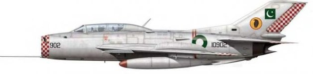

Shenyang FT-6, ‘10902/902’, 15 Squadron ‘Cobras’, Pakistan Air Force, Kamra, 1980s. Overall white with red/white trim, 15 Squadron ‘Cobra’ marking on fin
